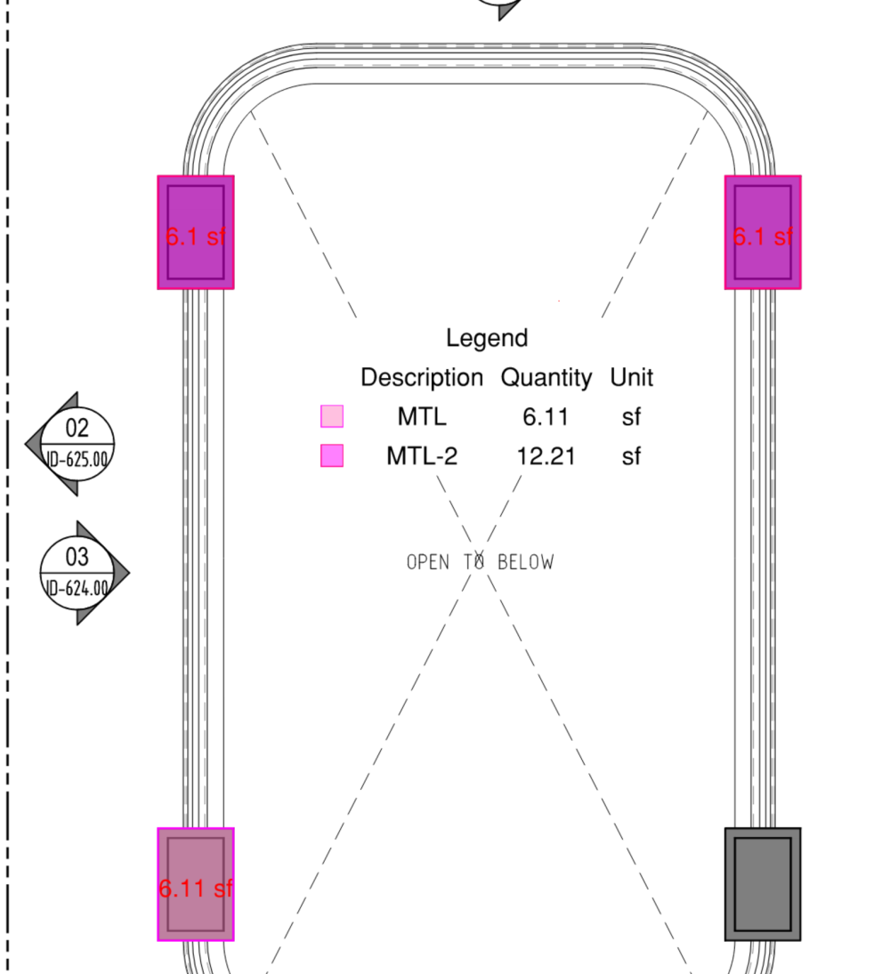

Is there a way to add together measurements between multiple pages? Say I markup a ton of items as MTL-2 over many pages; is there a way to add them all together? Like the legend below but for all pages with MTL-2
When you create your legend you can choose whether the data comes from the Current, All or a Custom Range of pages - select the Legend then in the Properties Panel look for the drop down menu called Source Pages(s).
