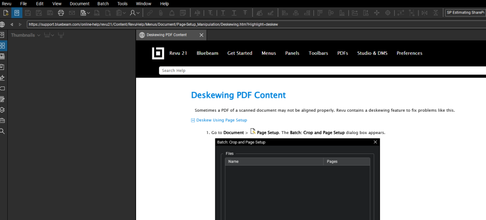

Try de-skewing the drawing first. Instructions are in the Help menu.

Open the Help menu in Revu.

for something like that you can do a few things. First, duplicate the page, de-skew the second page and have markups on both pages. You could take a snapshot, paste that on to a new page and rotate till its square, then flatten.
A few work arounds for you anyways
