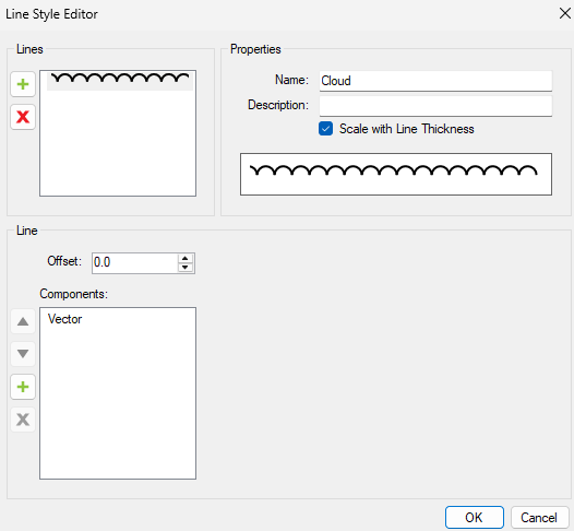

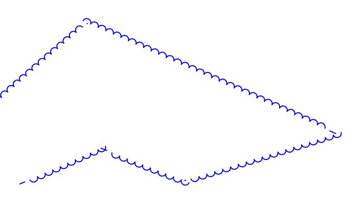

I was able to create a custom line assigned to a polyline type that got me close - it's a bit rough at the control point bends but you get the idea:

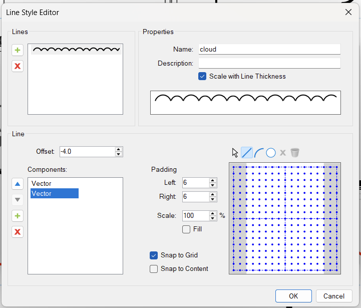

David,
Thank you! This is close enough for me. I forgot about the "arc" vector in the custom line editor. It was kinda fun to play around with the editor and I ended up breaking it. My second vector as disappear… but still there in the line 😐️
