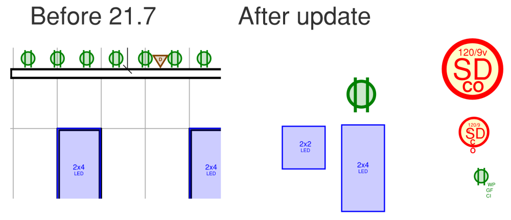

The issue I have noticed in the last couple of days is when I create a new PDF
Most of my markup tools are a lot bigger.
This does not happen on PDF’s created by other programs or with Revu prior to the 21.7 update.
I created them on on 1/8” scale.
If I change the markup scale to ¼” the markups go back to normal size but the text is off.
