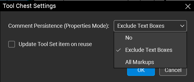

How did you navigate to this menu @Thomas Luedke? I have been poking around and do not see where these settings and choices are in the program?
Tool Chest Settings were added in 21.6 under the Tool Chest dropdown menu.
Exclude Text Boxes (default): Standard behavior of switching to Properties Mode allows you to use a text box with the freshly typed text as Comments.
No: Comments won't carry over to new markup placement.
All Markups: If you see Comments in the Tool Set Column, using that markup will use the Comments…even when using Properties mode.
