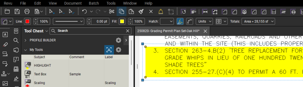

@rdbench I created an area measurement with a "0.0" line thickness, yellow color and highlight option selected. I changed the subject to "HIGHLIGHT" and saved this to the "1" spot in my "My Tools" tool chest. Now when I have one of those documents that doesn't like to highlighted cleanly I simple tap the "1" key and create a clean simple custom highlight.
Unfortunately, as @cvangorder noted below you don't have the benefit of capturing the highlighted text in the comment column, but for instances where this isn't needed the workaround gets the job done.
