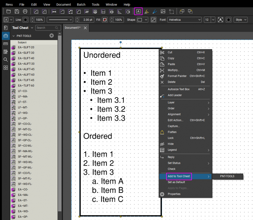

You just gave me an idea. Maybe this will help some in the meantime? I just made a bullet list using the character mapping you just used, and then saved it as a tool. Now I have a simple bullet list avaliable at any time. :)
I shared the tool set (attached) with just that tool in it in case it is needed for anyone browsing these parts.

For manual Lists, what I've done when I needed a List is:
Alt + 0149
I can then just click on it later and add a Text Box template to whatever page I want.
Take a Look:
