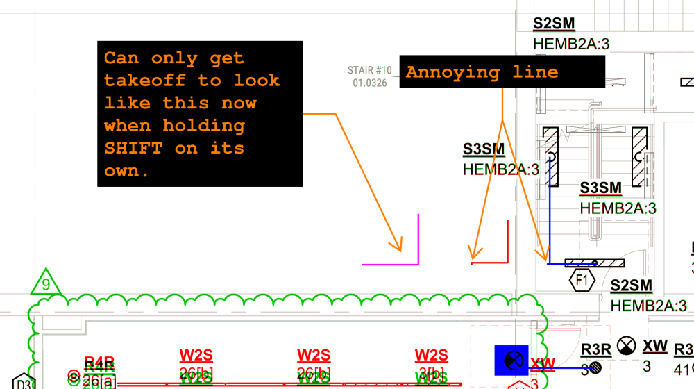

I do a good amount of takeoff in bluebeam and noticed an annoying issue after updating to 21.7. It used to be that you could use the CNTRL + Shift keys to do a straight takeoff line (shift key) and avoid any control lines or points on the drawing (CNTRL key) to get to a precise spot on the drawing.
After the update, the functions still work properly, however if you are holding down both CNTRL + SHIFT at the same time it adds this small little line onto your takeoff. One, it makes your takeoff look like its amateur hour and you can't draw a straight line, 2 it adds to the takeoff length. Obviously it is not a substantial amount but it does add an offset to the run and adds up on large takeoffs.
I have found a fix of not holding the control key. This works but now I am unable to pinpoint my exact stop point for the takeoff and sometimes my takeoff is extended to whatever control line / point it grabs on the drawings. It is also just annoying to not hold CNTRL + SHIFT and fly through takeoffs.

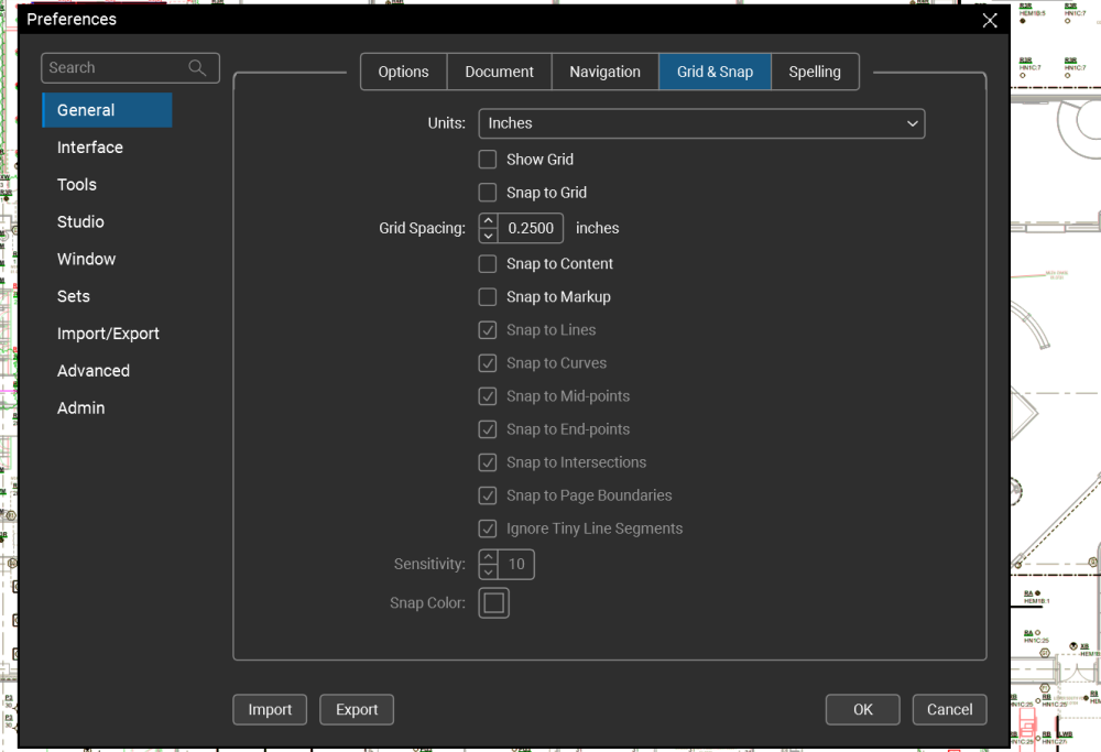

Is there a way to turn this off or reset the takeoff options to the way it used to be? I have screenshots but am getting a "Permission Problem" error on upload.
