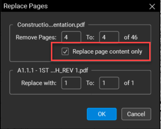

I would like to know, in the core plan, when I replace pages my markups are removed. How do I replace pages and keep al of my spaces and markups?
Check the box to replace page content only. This will leave the markups alone.
