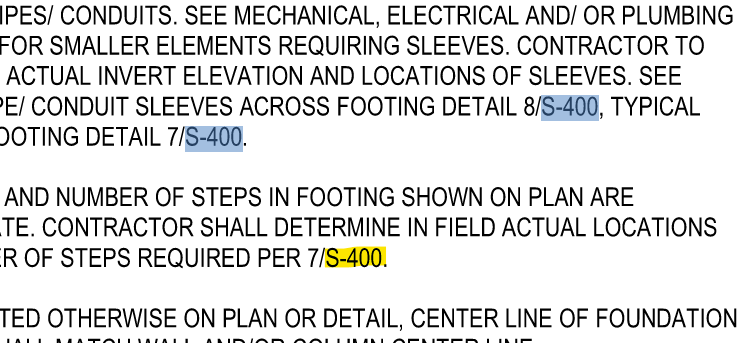

Hello, I'm having the same problem. When we run the batch link tool (using the latest version of Revu 21), some links are added, while others are ignored. In the attached screen snip, the blue links are created properly, while the highlighted text was missed.
All of the text comes from the same legend in Revit, using the TrueType font Arial-Narrow. Is this just a bug?
It looks like you're missing the screen snip.
So, I've encountered a similar problem recently. Basically, I was trying export some tables to Excel and a lot of the generated information was wrong - 2's became 9's, 1's became l's, etc.. To get over this I selected and changed the type of font. After exporting again, everything worked as it should have done.
Yes, I did! Sorry
