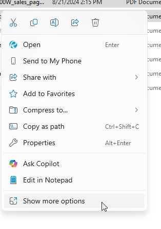

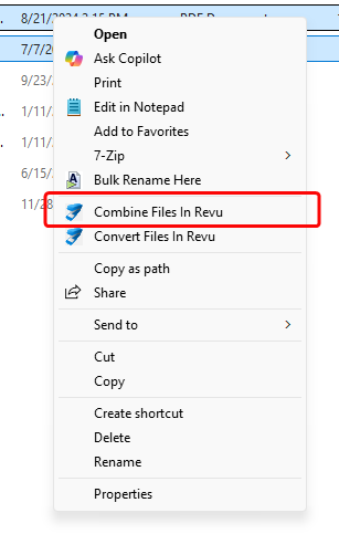

@Lee Pellegrin, There are a few ways to go about it. On the most basic level, I’d suggest using Combine Files in Revu. Just select the documents you want to combine, right-click, choose Show more options, and then click Combine Files in Revu.
You can do a similar thing when you already have a document open by inserting pages (Ctrl+Shift+I) or by copying pages from one file and pasting them directly into the Thumbnails panel of the current document.
