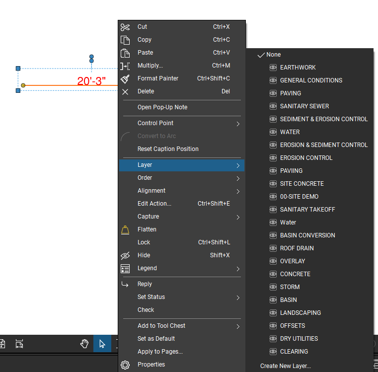

Layers are pretty easy to assign to a markup @Pamela Waltos.
Select a markup that you want to place on a Layer
Right click
Select the layer that you want to assign to the markup. If you don't already have a layer to use select "create new layer" at the bottom of the menu.
As a bonus you can turn off layers from this same right click menu by clicking on the "eyeball".
Hope this helps. 😎
