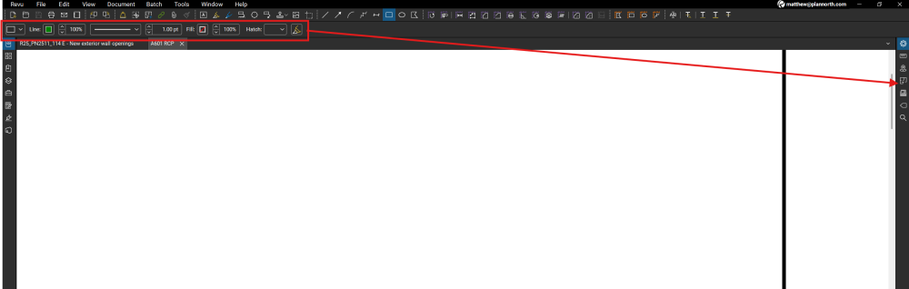

I am using the Revu Advanced profile. How do you move the properties menu from the top of your screen to the side of the screen? See below clip of where I would like to move it:

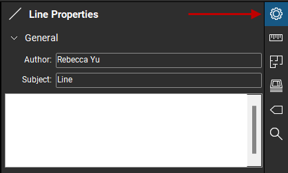

Full properties is already a tab for you, in this case it's on the top right of the tabs you are pointing to with the highlighted gear icon.

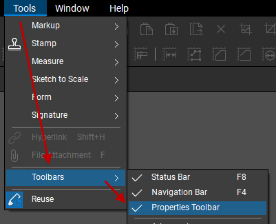

The lightweight properties toolbar that you see at the top of the screen that you want to move, you can toggle on and off if you don't want to see it by going to Tools > Toolbars > Properties Toolbar.
I don't want to hide it. I want to move it from the top of the screen to show on the side of the screen.

There's a Properties Bar and a Properties Panel.
The BAR is coded to drop in place where it does, and I don't believe it can be moved like a toolbar. The PANEL however can be moved to anywhere you like, including to another monitor.
I just found it, you'll see the gear in the left hand side of your screen — click on it and drag it over to the right hand side (where it's shown in the screenshot) and that'll get you back to normal operation!
