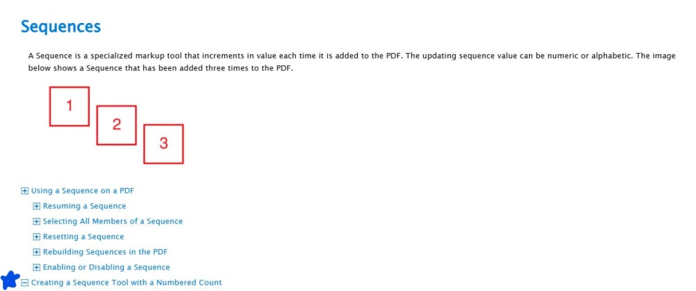

Is there a counting tool where i can just click click click while the numbers just appear? vs having to text box and manually type in numbers?
Good question @zbutler!
What you are looking for is a "sequence" markup. I don't believe there is a "standard" sequence markup available out of the box, but they aren't too hard to put together. 😎
There is a good resource available here:
https://support.bluebeam.com/online-help/revu21/Content/RevuHelp/Menus/Window/Panels/Tool-Chest/Sequences--MV.htm#Creating_a_Sequence_Tool_with_a_Numbered_Count
Yes! Thank you, works perfectly..
