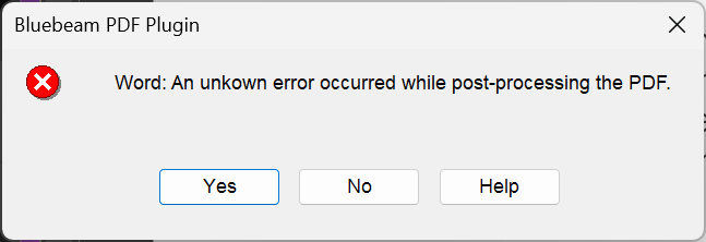

Curious if others have experienced this error when trying to PDF from the Bluebeam Add-in within Word and if you have any fixes:
Version: 21.6.1 Operating System: Windows 10

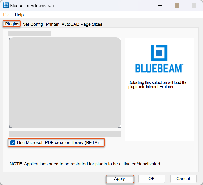

We did hear back from Bluebeam Support on this and have a work-around (at least for the Revu 21.6.1 version:
In Bluebeam Administrator, go to Plugins and check on the Use Microsoft PDF creation library (BETA)
Every file or specific?
Seems to be every file. Hard to say if it's specific users, or all of them since not everyone needs to PDF a Word doc, or uses the Plug-in to do so.
I used to have this issue all the time, truly frustrating. I don't have administrator rights, so my "work around" was to just print to PDF, which worked.
