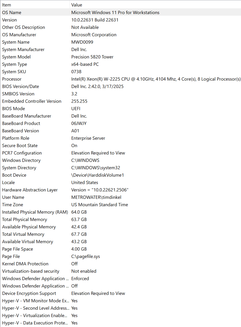

Is this a known issue, and has this been happening with anyone else? I know I have installed several updates over many months with this odd issue persisting. Since I work with my subscription on more than one PC, and this problem exists regardless, this should seemingly mean this is not just a single corrupted install? If you need to know what I am working on, this are my main work PC system info.
