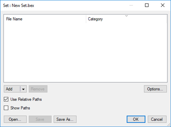

Now go to Sets >
New Set
Click the Add dropdown menu to add PDFs to the Set. You can choose between Files, Open Files, Folders, and Folders (including subfolders).

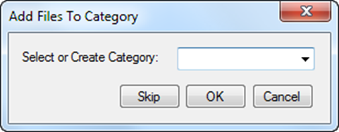

Now the Categories Template dialog box will appear.
You can either:
- Skip and turn set Categories Off

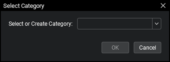

- Select a template from the Select Categories Template dropdown menu.
- Then select the category that these drawings should be sorted
