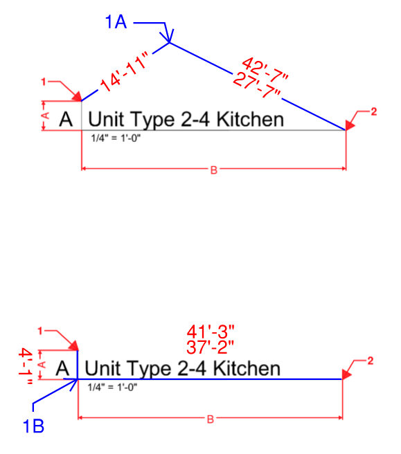

It would be helpful if a poly length measurement could be placed by clicking on two locations within a PDF that would then return the right angle dimension between the two points.
To clarify, you want to click on points 1 & 2 and get a measurement of A+B?
From a programming POV the challenge would be telling BB to keep the measurements orthogonal. And not everyone will want to measure the two points orthogonally, so you'll want to add a third point or angle from one point too.
Do you have an example of where you would use this?
The example you show is correct. I would want a sum of A+B. I work for an electrical company and we regularly use the polylength tool to measure between connected devices for prefab. It would be convenient to minimize those clicks and while the orthogonal snap wouldn't serve 100% of scenarios it would easily cover 90%+.
@Tony Tenbrink this seems to work on a quick idea:
Select your tool and click in order point 1, point 1A and double click point 2 to end the measurement
Select point 1A and drag towards point 1B - my setup seems to default to a 90 degree corner when I get to point 1B
It's a 2 step process, but would get you there.
Another option would be to click on point 1, then hold the shift key down as you click on point 1B and then continue to hold the shift key down while you click on point 2.
Either way it's at least a 3 click process, but it appears that it would give you the information that you need. 😎
